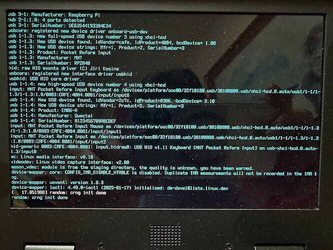

Hello,
After a seemingly smooth apt full-upgrade, my Pocket hangs on boot as shown. I have tried couple of power off and ons, but boot stops consistently at this stage…
Please help!
Thank you.
Hello,
Please help!
Thank you.

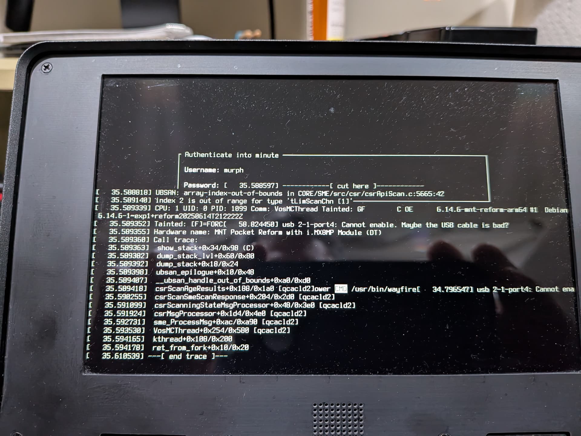

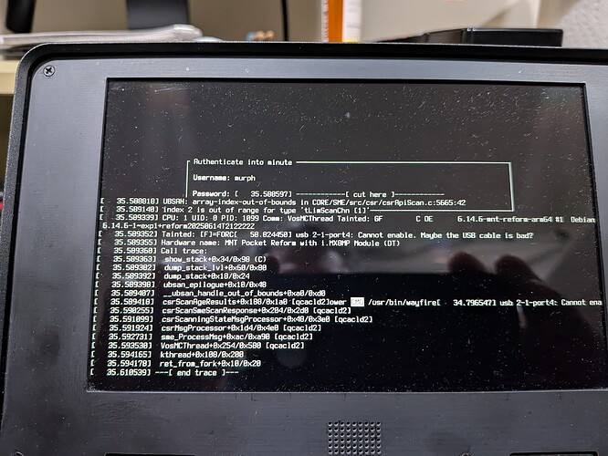

If it’s any help, I’m getting errors on start, but I am still able to log in. Here’s the error from the login screen. (Please pardon the dust)
I can enter the password over the errors, and it seems to work OK.
<edit: narrator: The charging problem was unrelated>
I hope that’s helpful in some way. IF more information is need to help anyone else, let me know.

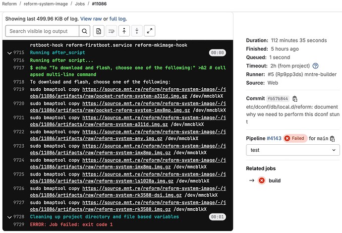

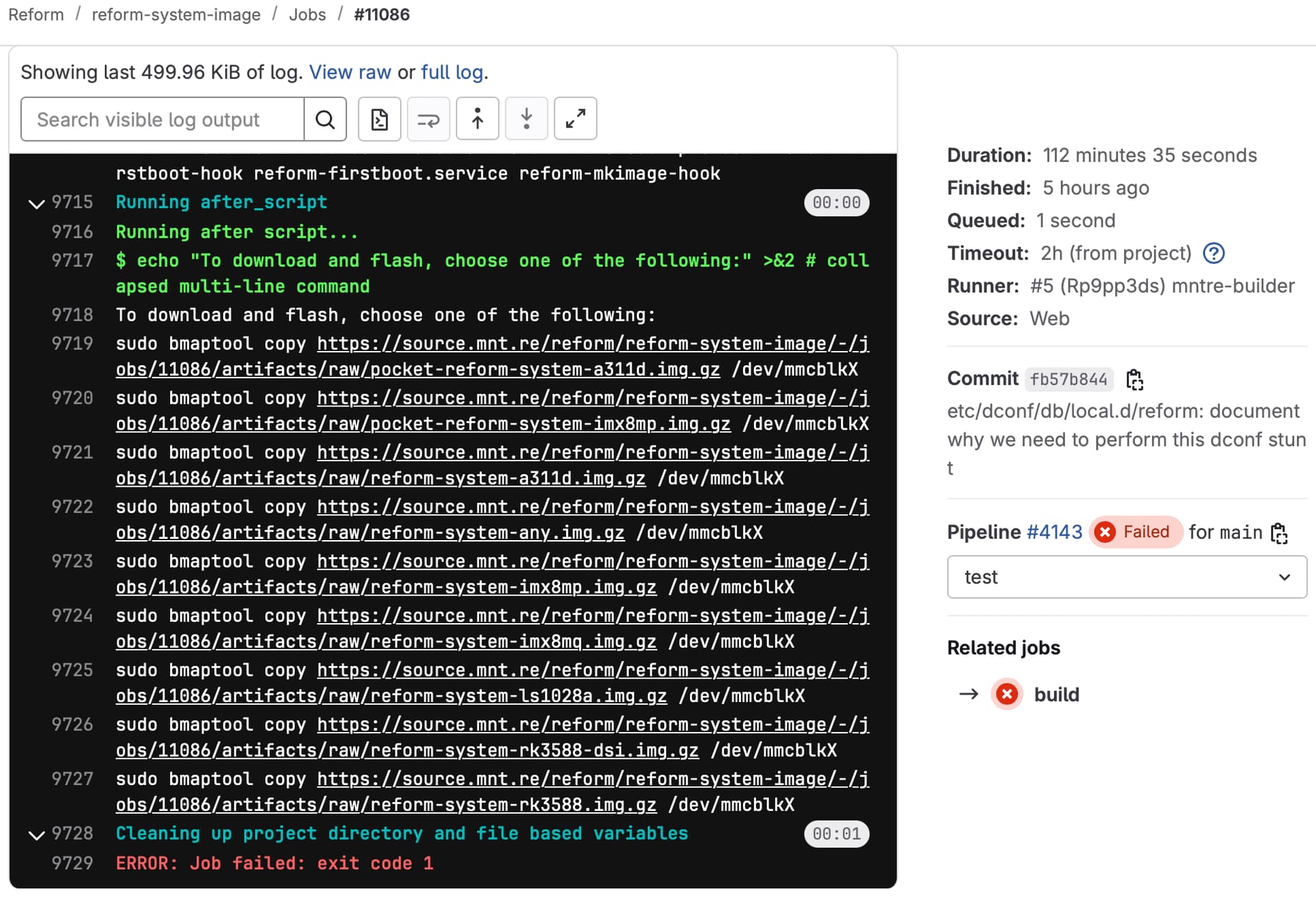

Hello @josch ,
When I click your build (#11086) link, I get this page with failed tag.
Something going on?
Oh dear, we need to investigate this…
Did you try out the idea of @murph? Type blindly your password and see if that logs you in? Maybe your tuigreet is just overwritten by messages?

Thank you for notifying me of that. This is fixed now and artifacts are here: Artifacts · build (#11200) · Jobs · Reform / reform-system-image · GitLab

The messages were just hidden before. If you want to go back to the “old” non-default loglevel from last year, you can follow these instructions: Login menu appears, is then covered by errors - #3 by josch
This is a known problem and minute is in the process of fixing it. This is part of the ongoing rework of communication between sysctl/lpc and the dkms driver.
Hello @josch ,
To my great surprise, what @murph was indicating turns out to be true. As the screen is filled with those turquoise colored messages, ignoring them and keying in LUKS password assuming as if the LUKS prompt is shown, and then later assuming as if the tuilogin shown and keying in login password brought to launch Wayfire session.

Hello @josch ,
The SD image from #11200 does boot up properly it seems.

The messages shown toward booting are just as plenty long as the #11086 SD card boot, but not as crazy as the one currently on my NVMe SSD.

Thank you for testing this! Thank you also for your video from your post before. I made minute aware of it on IRC and they said that they had something similar recently even on their intel machine. Maybe until we get to the bottom of this, you should configure a lower loglevel again.
If you don’t mind testing out system images, then that one comes with kernel 6.15 which I cannot test because I don’t have a i.MX 8M Plus Pocket Reform. I already successfully tested it with i.MX 8MQ, RK3588 and A311D and would very much appreciate help with it so that we spot problems before others run into it: Artifacts · build (#11201) · Jobs · Reform / reform-system-image · GitLab

SD card image #11201 did boot and did complete shutdown to power off on my Pocket Reform. Here is the video:
