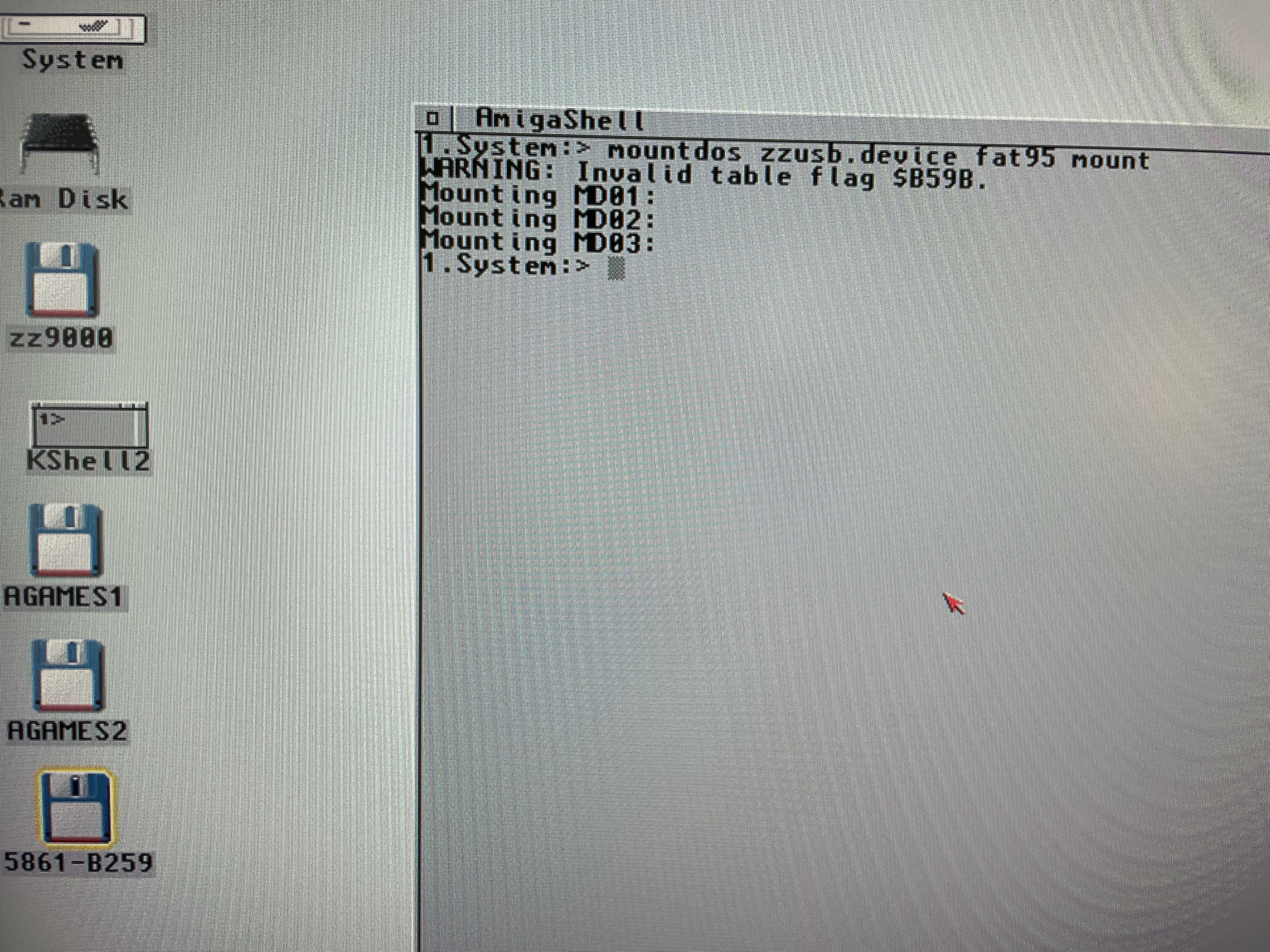

When mounting the drives with “mountdos zzusb.device fat95 mount” I get below warning about the flag table:
WARNING: Invalid table flag $B59B

I’ve actually only gotten it to work with one 16 GB usb stick that is partitioned with 3 x 3GB partitions using FAT32.
Other sticks even a 4GB one fails with mountdos with an error :
Device IO-Error $1E.
