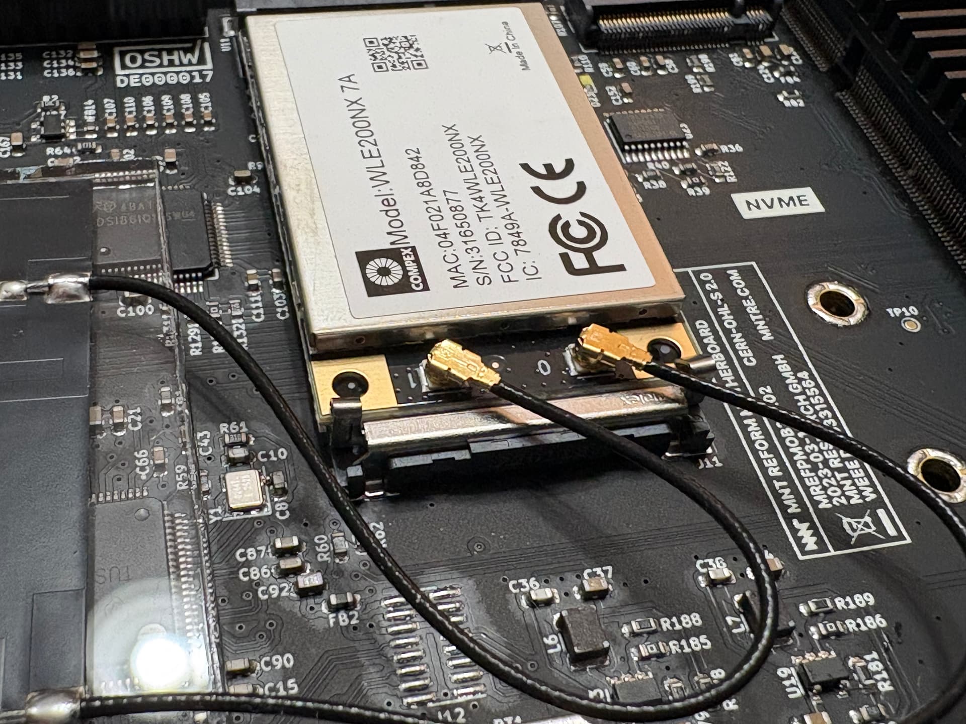

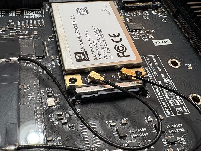

Can you show us a photo of how you connected your antennas?

Here’s the photo, I reinserted the card itself and made sure both antennas clicked in, still nothing:

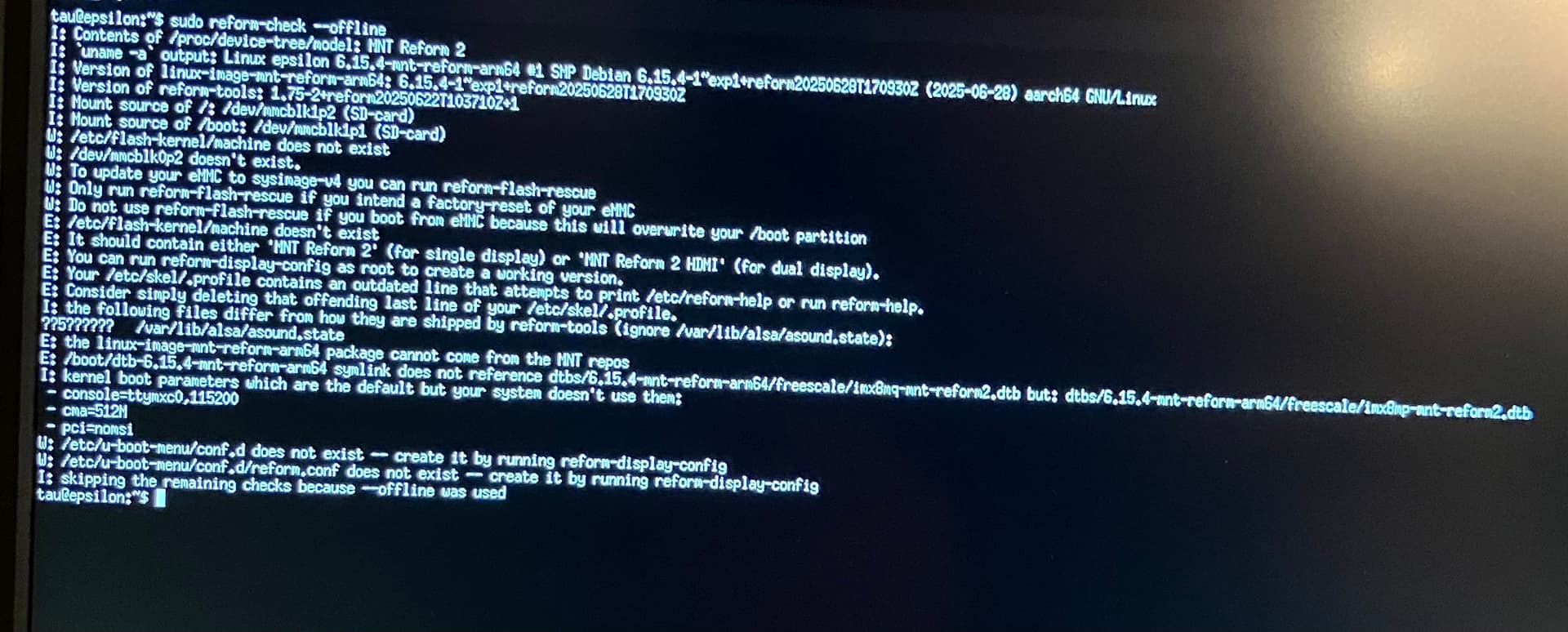

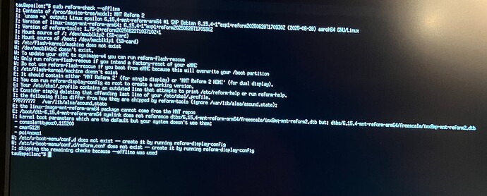

@geo could you send us the output of running sudo reform-check which will answer a bunch of questions in one go, like: are you using imx8mq? what kernel and reform-tools version are you on? do you have pci=nomsi in your cmdline?
Oh wow, minute was spot-on!
Indeed the reform-check output tells you that for some reason your system is not using pci=nomsi. Maybe your system is using an ancient u-boot version? Do you boot it with u-boot from eMMC or from sd-card?
You can use the first two images in this article to locate the DIP switch on your imx8mq: document boot options (#2) · Issues · Reform / reform-handbook · GitLab If it’s set to OFF, then your imx8mq will load u-boot from eMMC which might be ancient. You said that you loaded an up-to-date system image on an sd-card. If you flip the switch to ON, then it will use the latest u-boot from sd-card instead. And that should include options like pci=nomsi.
If you don’t want to flip the switch, then you can do the following to insert custom boot options. Create a file called /etc/flash-kernel/ubootenv.d/01pcinomsi and fill it with the following line:
setenv bootargs "${bootargs} console=ttymxc0,115200 cma=512M pci=nomsi"
If you don’t want to type much, you can also start with just listing pci=nomsi for a start and see if that worked. You enable the change you did by regenerating /boot/boot.scr running the following command:
sudo flash-kernel
Theoretically, the default boot.scr should guard against this. There is an if test "${board}" block I put above to make sure that what you experience does not happen. I would find it very interesting to get a hold of the u-boot version flashed to your eMMC and prevent the next person from running into this issue. If you like, after you have your system working with wifi, send me boot0.img created by the following command:
