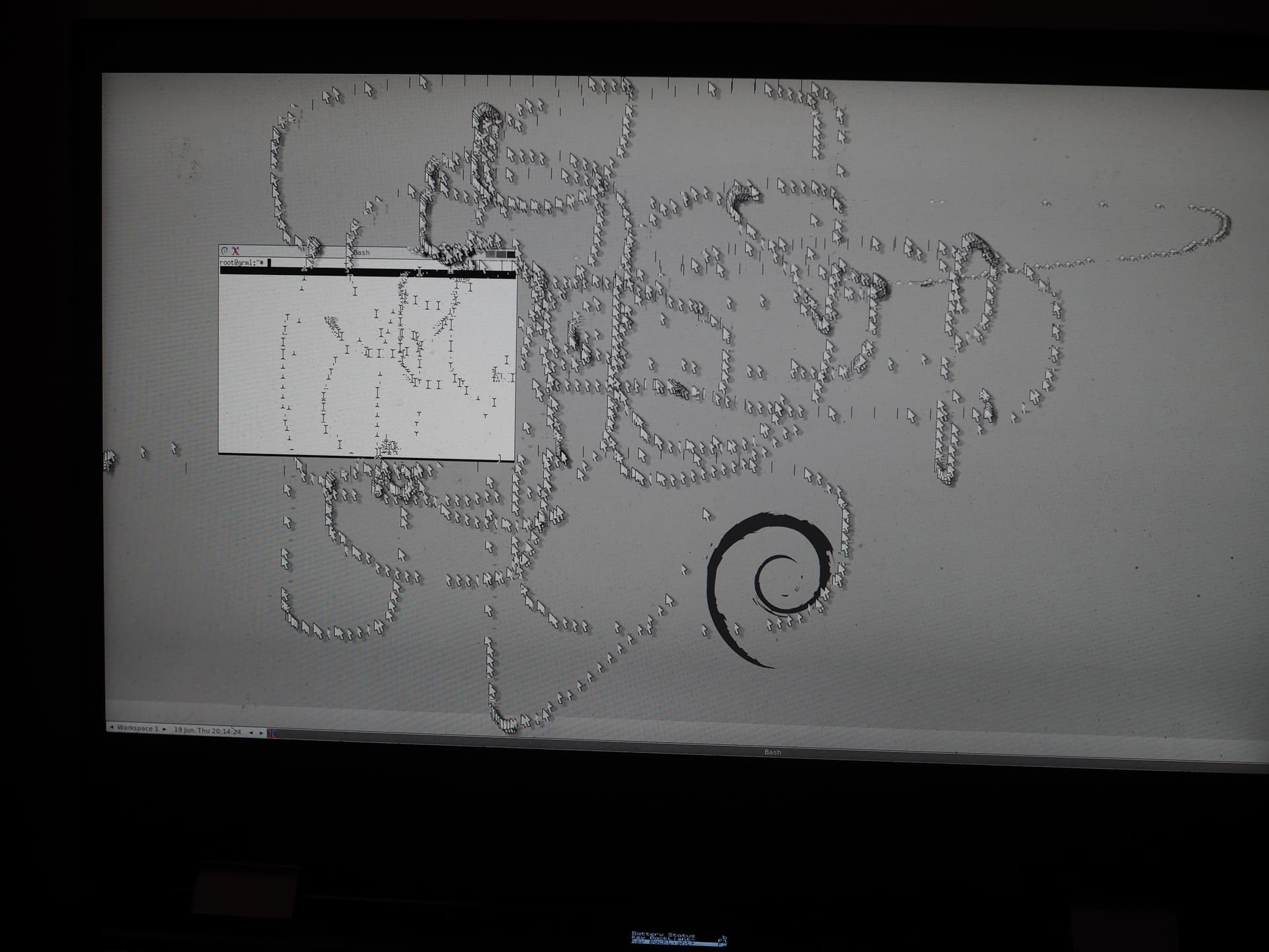

Xorg “works” on imx8mq/etnaviv using your config from Classic X11 with Config File
But when moving windows and the mouse cursor, there are artifacts (this is fluxbox with grml):
