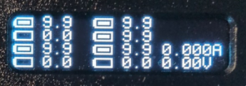

The SWAY bar fluctuates between 0% and 100% battery charge every minute.
The OLED display always shows 100% battery charge (even after 2 hours of use).
The laptop shuts down without warning.

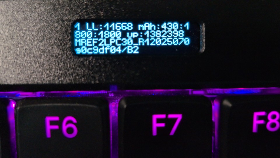

I hope your problem is fixed now. In IRC minute wondered yesterday how the problems you saw could’ve happened. One theory was that you are maybe running a custom keyboard firmware? Do you know which keyboard you have?
Hi Josch,
I updated the keyboard firmware a few weeks ago as described here:
I didn’t install a custom one.

After running the apt full-upgrade, the displays (OLED and SWAY bar) are back in sync, and the sudden shutdowns have stopped.
However, both displays remain at 100%—even after 3 hours of battery use.

For me (v2.5 motherboard, rk3588), I saw the LPC display consistently show the right battery voltage and level. The OS, however, was throwing tons of error messages about not being able to communicate (like in the other thread) and the battery display in Gnome was swinging wildly between 100 and 11 and 30 and 5 and 0 every few minutes, regardless of what the LPC showed or whether I was plugged in or not. And if it stayed on 0 too long, UPower would shut it down. I did try and figure out how to configure UPower to not do this, only to discover that there is no way to override this, apparently (although it looks like Arch has a package with a patched UPower that allows “ignore” as an option).
I’ve just updated to the most recent release of reform2-lpc-dkms (deb version 1.86-1+reform20260327T215213Z+1 via apt full-upgrade, so other stuff also updated) and now the OS and the LPC displays agree again.
I am not seeing either display stuck at 100% (right now, both are at 95%, at least under Gnome)

Lucie suspects that the problem might’ve been that you were using a firmware with a different version string than the version logic was prepared to handle and submitted a potential fix. So I’d have two requests if you find the time:
  1. what keyboard and what keyboard firmware (and which version) are you running?
