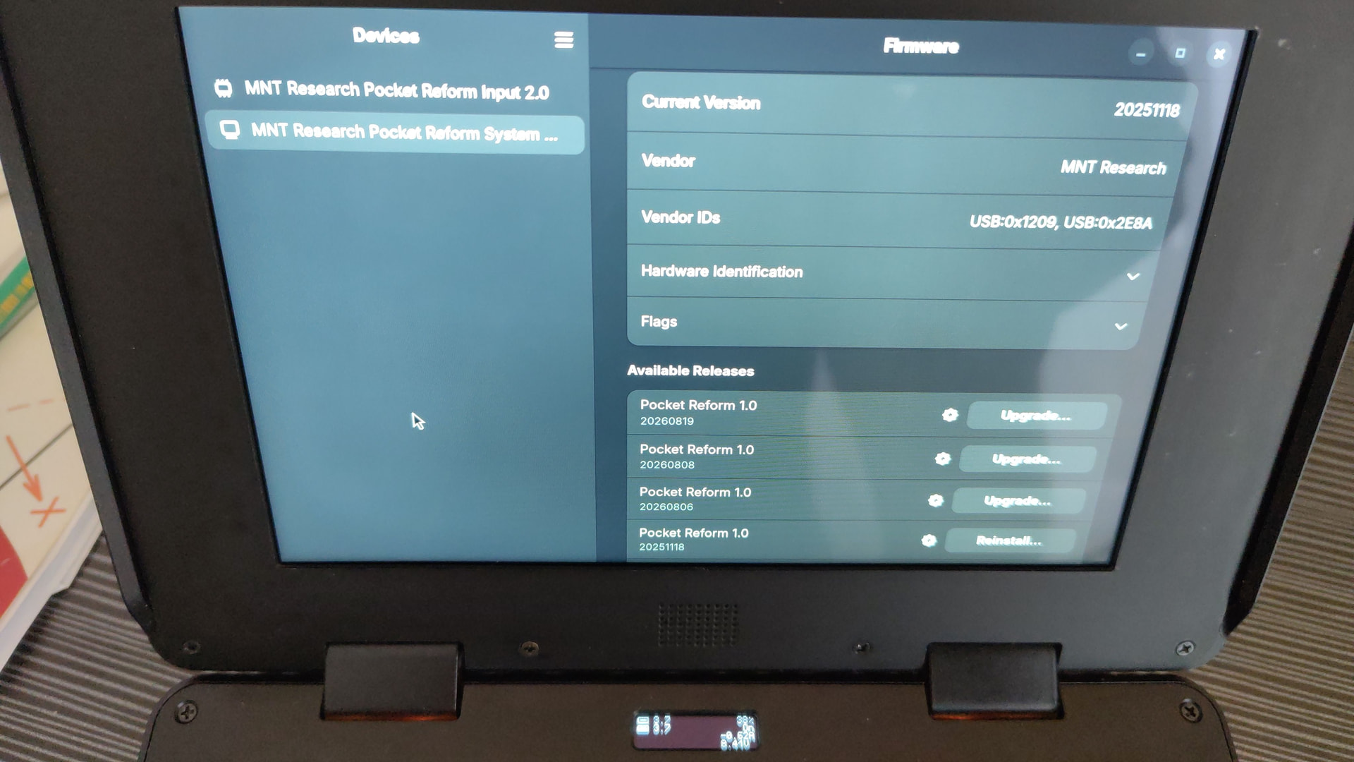

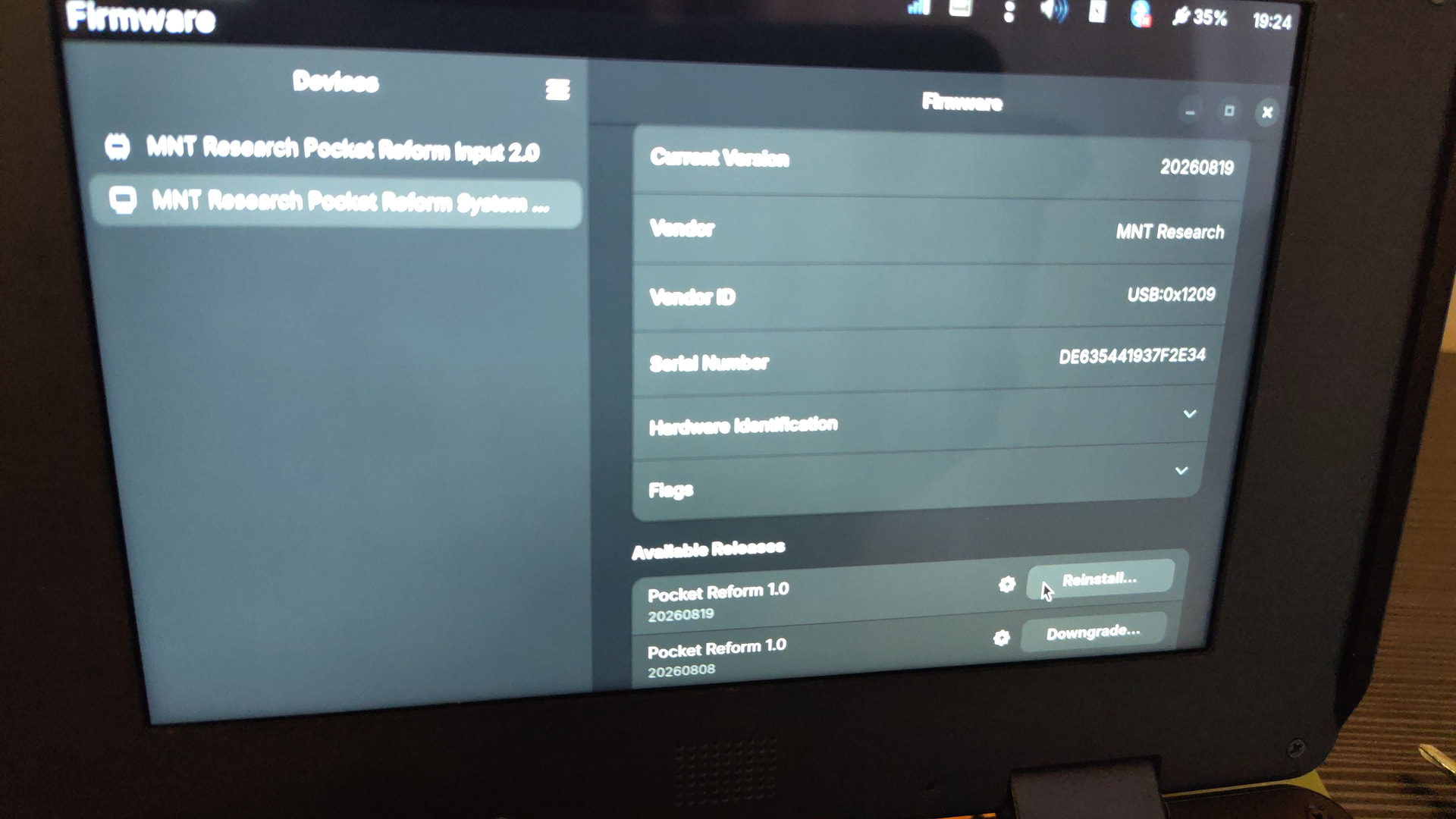

After updates, the battery charge only decreases.
I downgrade the firmware version, the battery was charging but very weakly, and then the system stopped booting, so I reverted to the latest version.

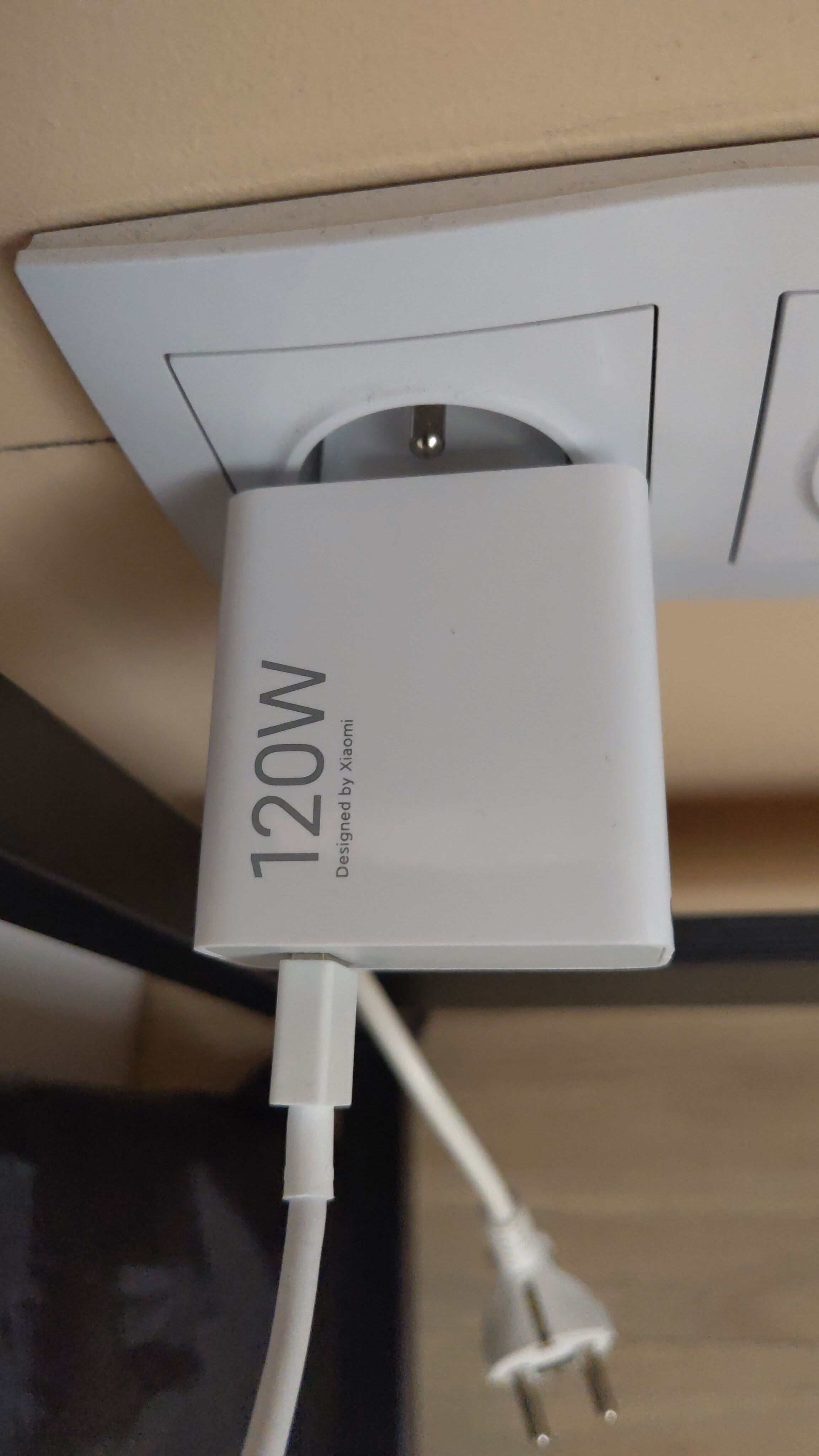

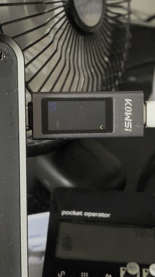

I recently had to use a macbook charger (the bigger one) and seen this exact behavior, it charges for few seconds and then stops charging completely. I think this is new, because I recall charging from a macbook charger last winter and it was working. Normally I charge my Pocket with some ugreen charger, and the standard steam deck charger (both not as powerful as that macbook charger) - those are working fine even today, I can see Pocket getting around 1A rock solid, both cells are at 4.1v.

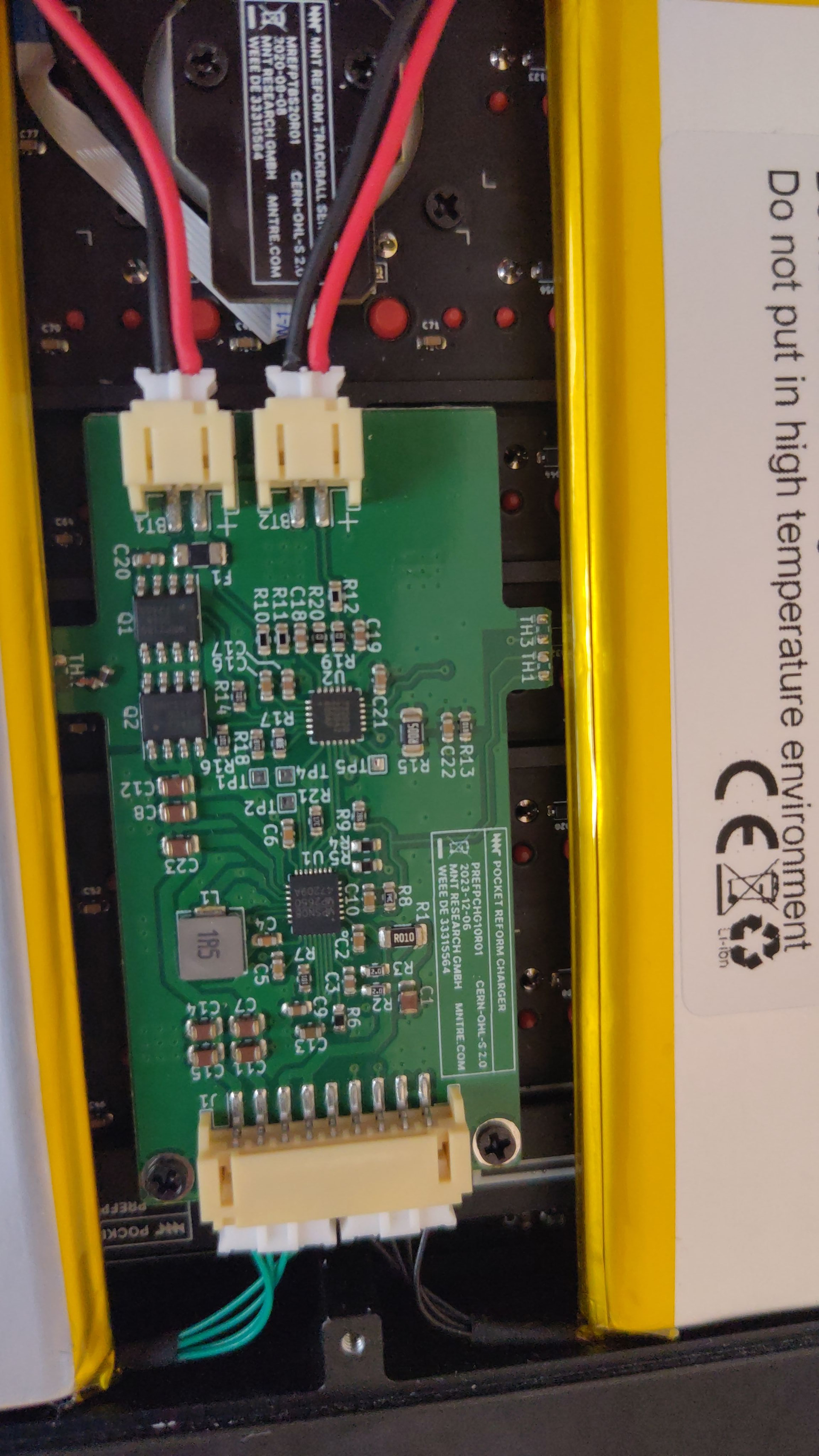

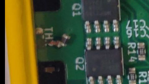

Your charger board is slightly damaged, the thermistor th2 is knocked off, which could explain this behavior. I didn’t spot this at first when looking at your post a few days ago.
Could you kindly complete the process from this step on MNT Support
After completing the last step we’ll send you a free replacement charger module V2.0. You can also include a link to this thread here.
BTW if the cells discharge, you can use the bypass technique explained in that support process to use the Pocket Reform without batteries for a while, for example with a powerbank, until you get your new charger board.

  1. Is your charger board physically OK? (No knocked off components)
  2. Can you record some logs from tio /dev/ttyACM0 when you plug in the USB-C power supply and it’s not charging like expected, and post here? Doesn’t have to be a lot, just to see if the PD negotiation works and what happens shortly after.
1: yes it is

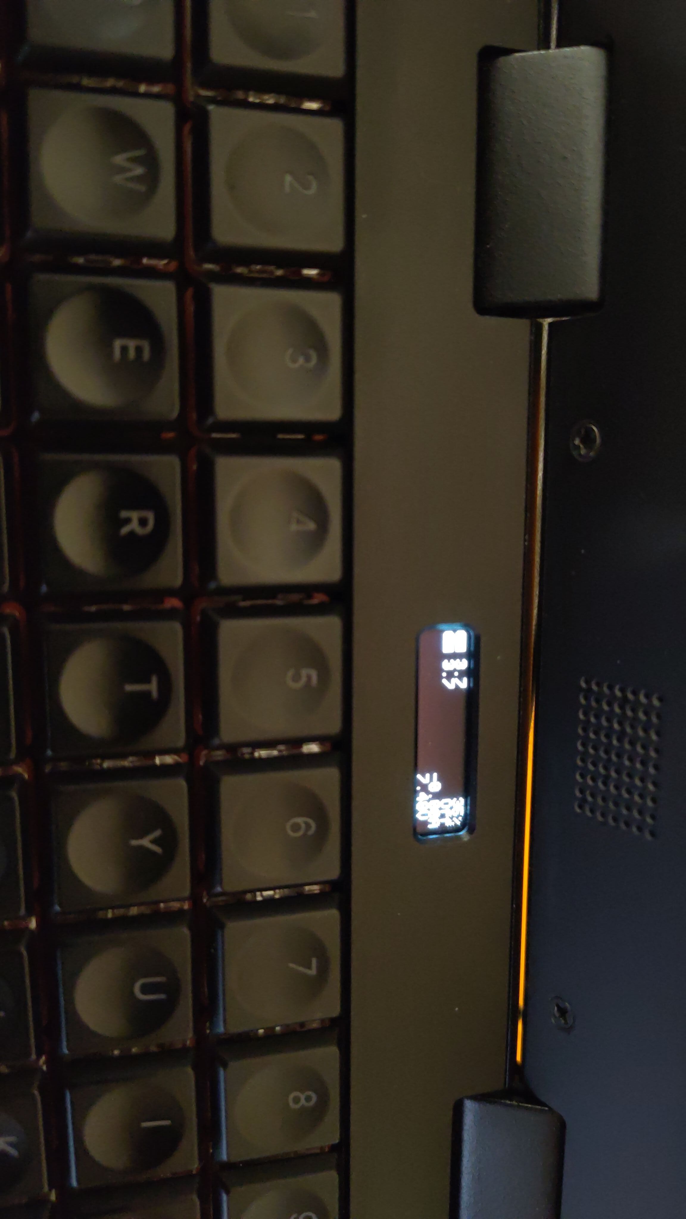

ok so here’s the logs i got. the annoying part is they don’t seem any different but the behaviour is very different. first up is what it says when it works normally, and charges at -1.6a to -2.4a:

next up is the first time i caught it behaving oddly when it was only charging at about -0.6a:

now this seems like it could be a safety feature, but it works poorly if so since after fully charging, the device still drains when this happens, resulting in a slow trickle of drain. since i plug it in to recharge when i do (sleep) it can end up being under 60% by morning sometimes. it’s like the device can’t run off the charger without touching the batteries, like maybe the BMS doesn’t have a bypass to make it run off charger and then switch back when unplugged? if so i can submit a hardware improvement request unless board V2 fixes this, but maybe it’s not that.
for context on the test environment: the device was in the exact same state when plugged in for all three, so the charger was not just being maxed out due to load being higher and thus, less headroom to actually charge with, and those extra lines afterward appeared when i hit Hyper+Enter b to check charge rates.

The power controller arrived for replacement. The laptop works, but it doesn’t charge and the update option has disappeared in gnome-firmware.
sudo fwupdmgr update
WARNING: UEFI ESP partition not detected or configured
See PluginFlag:esp not found · fwupd/fwupd Wiki · GitHub for more information.
Devices with the latest available firmware version:
• Pocket Reform Input 2.0
• Pocket Reform System Controller 2.0
Hey I just wanted to chime in here as well. I have been using the charger that came with my Macbook pro 13 m1 to charge my Pocket Reform (3588, charger b oard v2, ordered december 2025) without problems.
I recently did the firmware update.
A few days ago I charged my Pocket for a few hours while it was powered on, only to come back and see that it was only at 14%. Checking the oled I could see that the voltage was going 0, -0,2, -0,35, -0,8, -1, 0, -0,2, .0,35, .0,8, -1, 0, (something like that.) maybe a bit higher but it would always drop down to 0. Like a loop getting a bit of charge and then giving up.
I tried with a different non-Apple USB-C brick and it worked perfectly. Constant - charge and a good number.
This looks like a behavior I’ve reported above. Since that time I was able to try with another macbook charger, and it also fails in the similar way. This is how it looks externally.
