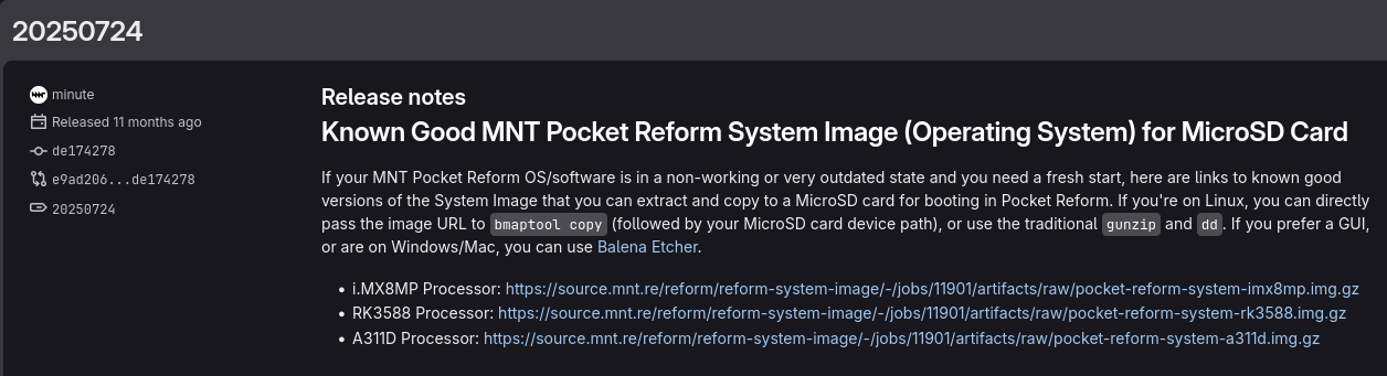

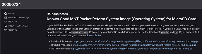

That link “MNT Pocket Reform Firmware and System Image Instructions” links to https://source.mnt.re/reform/pocket-reform/-/releases which lists version 20260227 as the latest release and that is correct. That version is even newer than what gets distributed via fwupd which only lists 20251118 as the latest version. I also managed to download the build artifacts. Where exactly did you see the expired artifact links? Lets fix those. :slight_smile:
Those 3 links lead to 404 errors. If I was to follow instructions, would have use them :slight_smile:
Ah you were reading the release notes of a past release! You are right, those links should be removed. I pinged Lucie on IRC to perform that removal.
