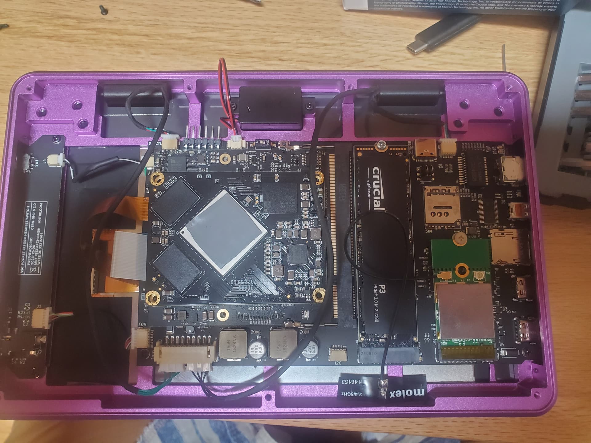

Probably not related to your immediate issue but the Wifi antenna is supposed to be taped to the backplate (the black PCB piece with the big MNT logo on it), away from the big copper area. The spot where you antenna is sticking now will probably be under that copper piece, which will block your wifi signal and make the connection unstable.
The CPU module looks misaligned in the motherboard connector. I would suggest removing and re-inserting making sure the contacts are aligned with the connector along the whole length. I also think you need a couple of screws that will push and hold down the CPU module to make proper contact.

Based on what I see in the picture the module appears to be in a slight angle and may not be making contact in the top. You can push it in slightly before pushing down to get the metal clamps to hold it.
Thank you for the head’s up ! I’ve attached it to the back plate.
@pff @selfawaresoup You where right about it being misaligned, I was able to push it in a bit more. Unfortunately that still does not fix the problem. I’ll go recheck the other pieces with similar clamps.

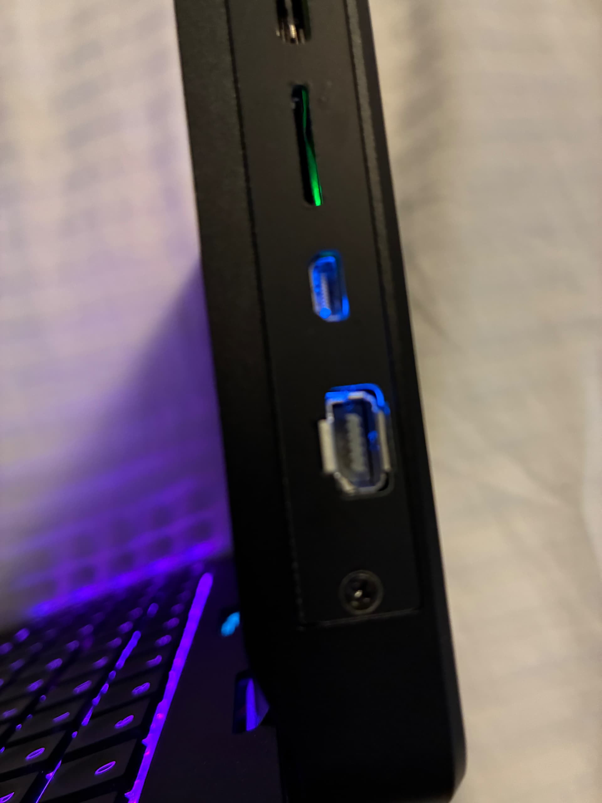

As soon as I power my pocket on with the keyboard I see a blue light come on. Then it takes 5-10 seconds for the screen to light up.

Do you see a blue (or green) LED light up from the side when you try to turn on the computer via the keyboard?
It would be good to figure out if the motherboard is turning on even thought nothing comes up on the display.
Oh I’m realizing now that the switch I touched on the motherboard was already in the ON position, so I put it back, now I get that light. A green light in the center, a blue light on the side and the keyboard backlight.
But the display still isnt showing anything.
