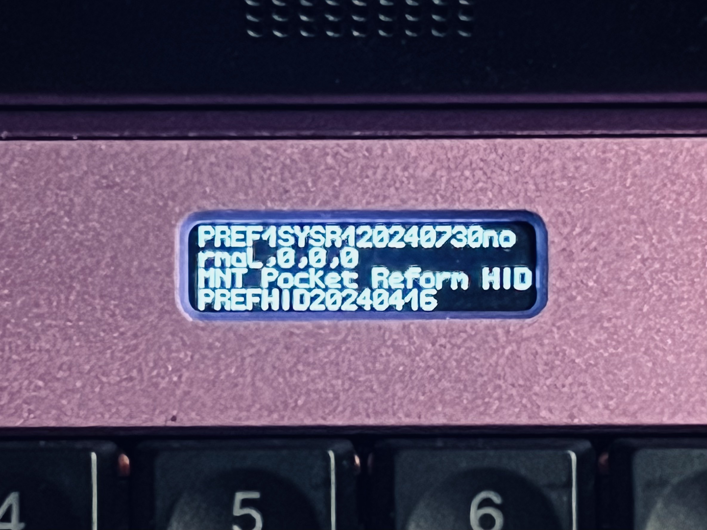

how do I determine the keyboard firmware version? Is it the same as what the OLED display shows under “system status”?
Yes, there are two fw versions written there normally, you can also show a photo if you don’t wanna type that all in.

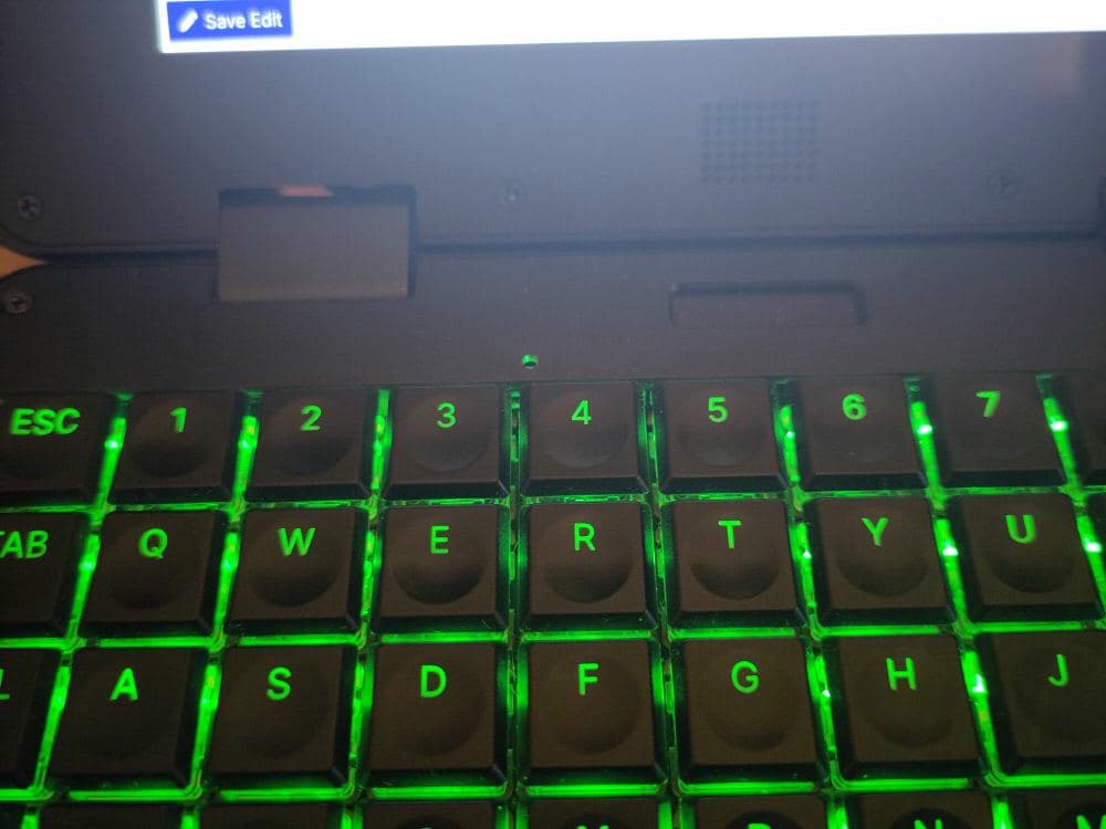

I actually drilled a hole in my kb cover so that I could manually reset the kb. It is getting to the point now where even manually resetting the controller is not resolving the issue.

Here is a picture of the hole in the kb top cover that I made:

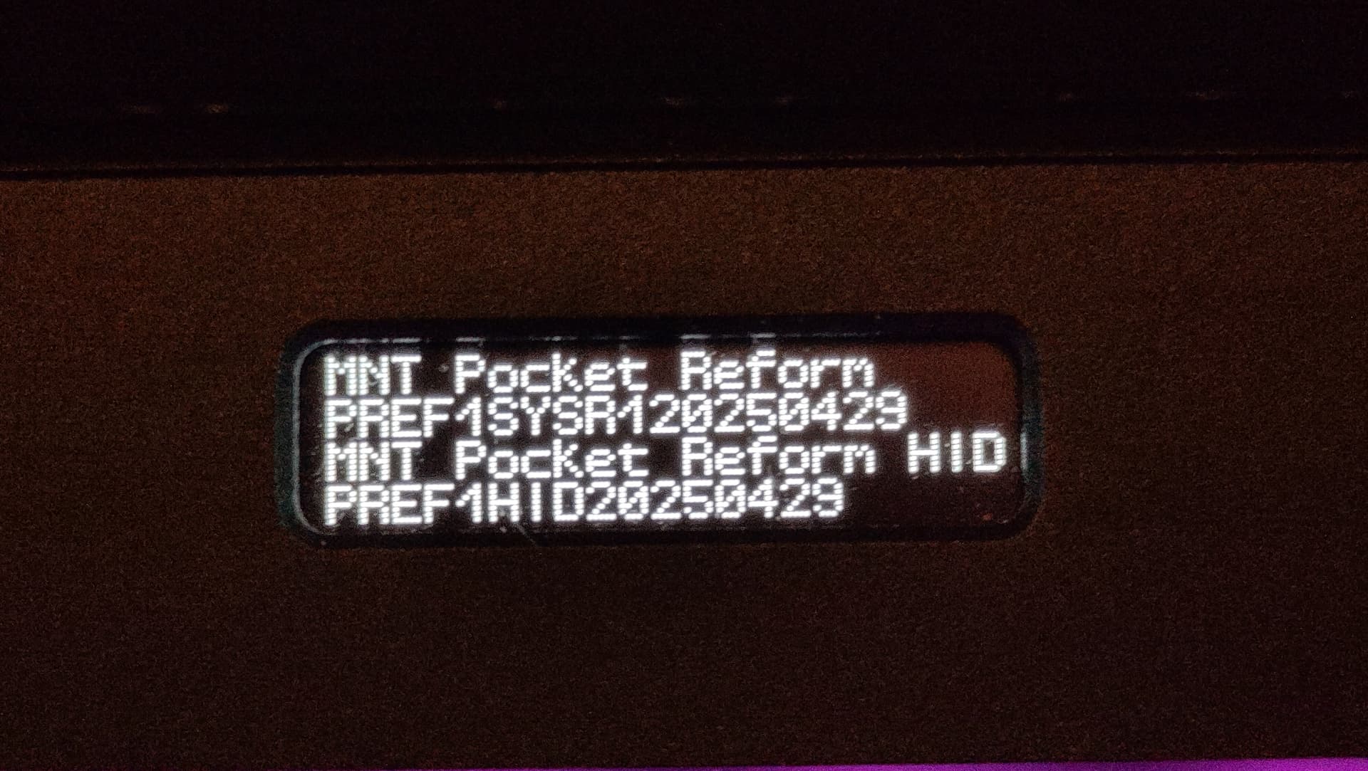

Glad to hear! Maybe the second try was exactly after I pushed the update? ^^ In any case, can you confirm that both date strings in the OLED menu’s System Status page now show 20250429?
Updated! Thanks @minute!
