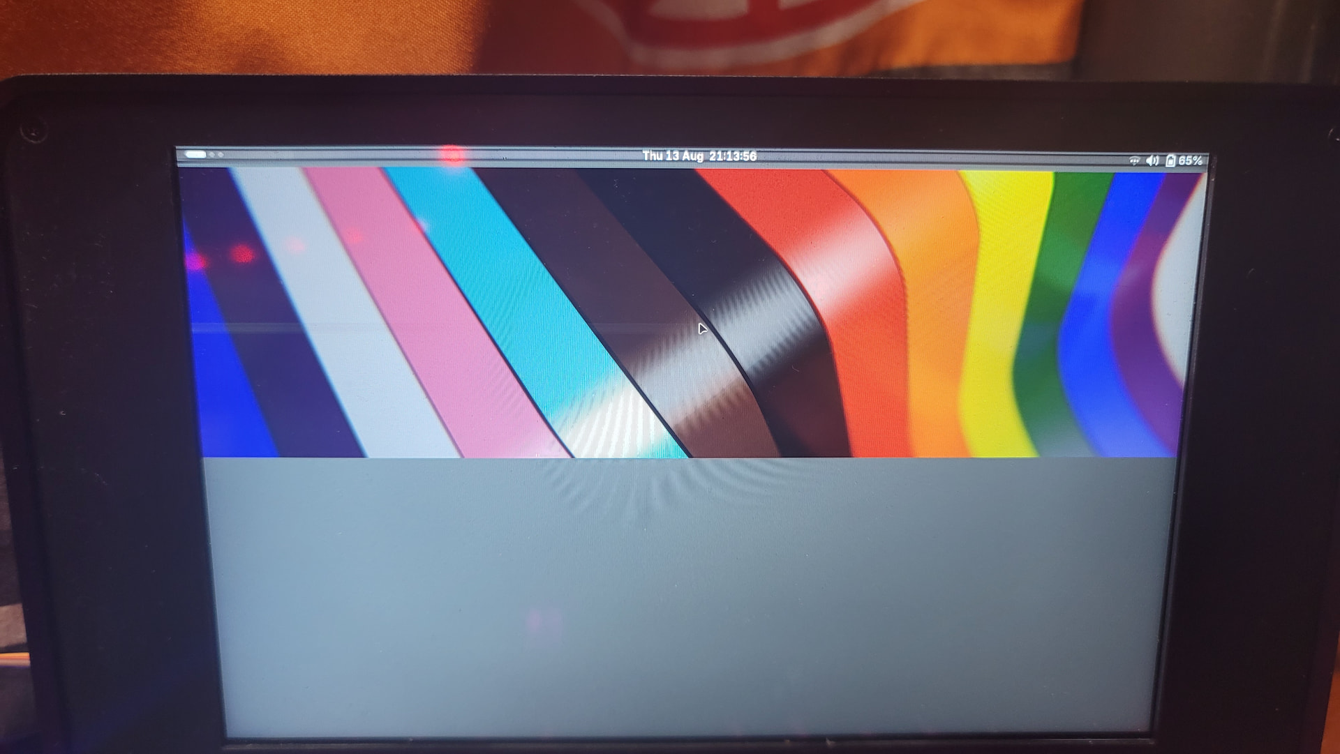

No battery status and brightness control with trixie-backports
alright i’ll go off on my own and when i give up/take a break i’ll just dump everything i did, full UART outputs n such.
thanks for the help so far
Hmm it seems like I’m having a similar issue on the regular mnt image after doing an apt update && apt full-upgrade today. Boot took forever because it couldn’t see BAT0 status. When it did boot yeah no battery monitoring and internal screen just froze grey logging into gnome. Kernel Linux 7.1.8-mnt-reform-arm64 and reform tools 1.88-1+reform20260803T142427Z+1.
If I’m reading this thread right I just need to upgrade the system controller firmware? I’m on 20251118 currently.
You are on Pocket Reform with A311D?
Did you read Important note about the new MNT Pocket Reform kernel and firmware updates 20260808 (updated)
Was just coming back to post an update. Ooops, no admittedly I have not been on the forums much recently. My reforms have been working too smoothly I guess. I’m on the RK3588, but I just updated the controller from a backup SD card I keep taped to the machine for just such situations. We are good now. Thanks.
i ended up giving up. gonna call it for today.

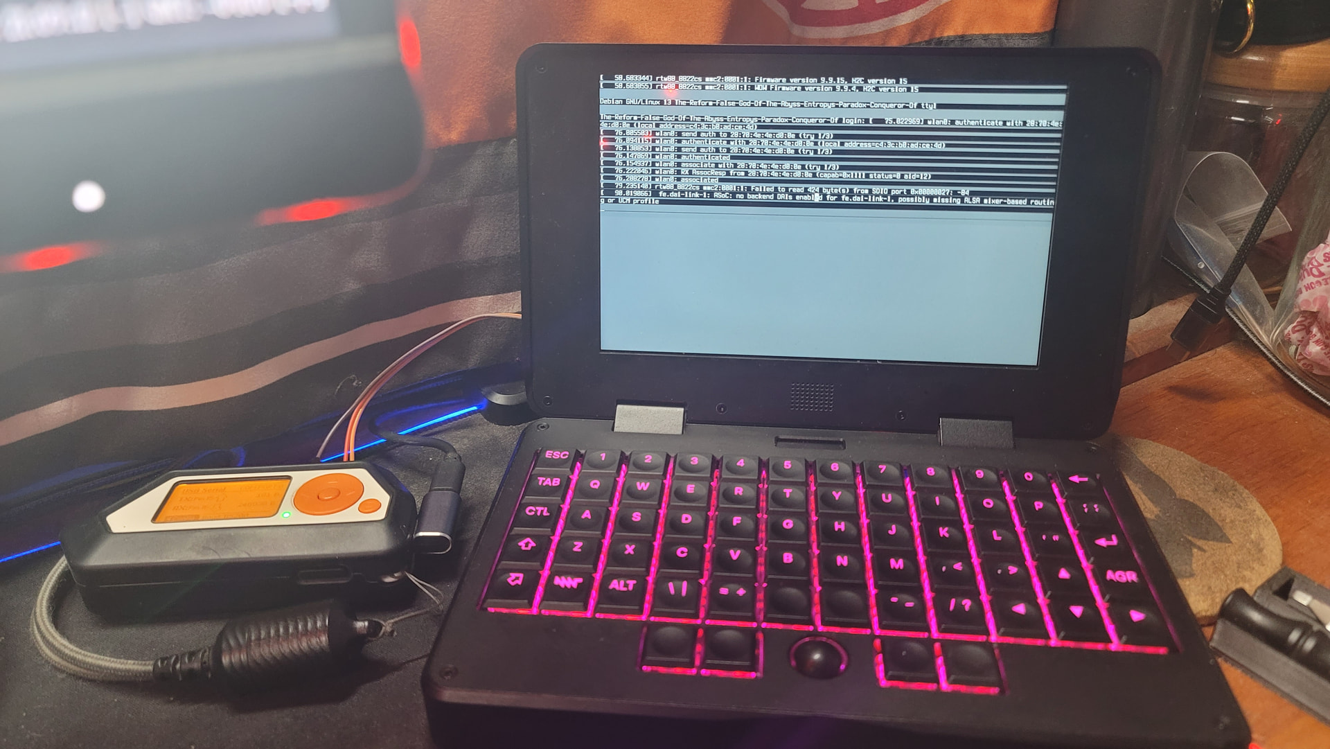

no dice, official image hangs. here’s UART from boot to hang.
[20:39:05.555] tio v2.7
[20:39:05.555] Press ctrl-t q to quit
[20:39:05.556] Connected

[    7.168655] SPI driver mnt_sc has no spi_device_id for mntre,system-controller
[    7.170335] mnt_sc spi0.0: MNT System Controller v4
[    7.182682] meson-dw-hdmi ff600000.hdmi-tx: Detected HDMI TX controller v2.01a with HDCP (meson_dw_hdmi_phy)
[    7.187410] meson-dw-hdmi ff600000.hdmi-tx: registered DesignWare HDMI I2C bus driver
[    7.195544] meson-drm ff900000.vpu: bound ff600000.hdmi-tx (ops meson_dw_hdmi_ops [meson_dw_hdmi])
[    7.216912] panel-mnt-pocket-reform ffd07000.dsi.0: [jdi_panel_probe] start...
[    7.218559] mnt_sc spi0.0: [mntsc_gpio_set] (set-gpio 0 1)
[    7.226797] mnt_sc spi0.0: mntsc: couldn't parse response: err undf
[    7.293808] reform2_lpc: loading out-of-tree module taints kernel.
[    7.294360] reform2_lpc: module verification failed: signature and/or required key missing - tainting kernel
[    7.329176] mnt_sc spi0.0: [mntsc_gpio_set] (set-gpio 8 0)
[    7.333047] panel-mnt-pocket-reform ffd07000.dsi.0: [jdi_panel_probe] jdi_panel_add done.
[    7.337258] panel-mnt-pocket-reform ffd07000.dsi.0: [jdi_panel_probe] done.
[    7.345007] meson-drm ff900000.vpu: Queued 2 outputs on vpu
[    7.350045] meson-drm ff900000.vpu: viu-hold-fifo-lines from device tree: 0
[    7.356640] meson-drm ff900000.vpu: CVBS Output connector not available
[    7.392595] meson-dw-hdmi ff600000.hdmi-tx: Detected HDMI TX controller v2.01a with HDCP (meson_dw_hdmi_phy)
[    7.397112] meson-dw-hdmi ff600000.hdmi-tx: registered DesignWare HDMI I2C bus driver
[    7.405147] meson-drm ff900000.vpu: bound ff600000.hdmi-tx (ops meson_dw_hdmi_ops [meson_dw_hdmi])
[    7.413904] [drm] Initialized meson 1.0.0 for ff900000.vpu on minor 1
[    7.421269] panel-mnt-pocket-reform ffd07000.dsi.0: [jdi_panel_get_modes] panel_version: 0
[    7.428201] panel-mnt-pocket-reform ffd07000.dsi.0: vsync-shift from device tree: 1
[    7.435856] meson-drm ff900000.vpu: [drm] kms: can't enable cloning when we probably wanted to.
[    7.520146] panel-mnt-pocket-reform ffd07000.dsi.0: [jdi_panel_prepare] prepared: 0
[    7.520165] panel-mnt-pocket-reform ffd07000.dsi.0: [display] init in prepare...
[    7.520170] panel-mnt-pocket-reform ffd07000.dsi.0: [mnt_panel_power_on] panel version: 0
[    7.624130] panel-mnt-pocket-reform ffd07000.dsi.0: [jdi_panel_init] enabled: 0 prepared: 0
[    7.645140] meson-dw-mipi-dsi ffd07000.dsi: Timeout during read operation
[    7.645157] panel-mnt-pocket-reform ffd07000.dsi.0: [mnt_panel_detect_version] read register 12a: 0x0
[    7.645164] panel-mnt-pocket-reform ffd07000.dsi.0: [mnt_panel_detect_version] panel not ready (-110).
[    7.645171] panel-mnt-pocket-reform ffd07000.dsi.0: [mnt_panel_detect_version] detected panel_version: 2
[    7.645176] panel-mnt-pocket-reform ffd07000.dsi.0: [mnt_panel_power_on] panel version: 2
[    7.645190] mnt_sc spi0.0: [mntsc_gpio_set] (set-gpio 0 0)
[    7.752118] mnt_sc spi0.0: [mntsc_gpio_set] (set-gpio 0 1)
[    7.876102] meson-dw-mipi-dsi ffd07000.dsi: failed to write command FIFO
[    7.897117] meson-dw-mipi-dsi ffd07000.dsi: failed to write command FIFO
[    7.918115] meson-dw-mipi-dsi ffd07000.dsi: failed to write command FIFO
[    7.939135] meson-dw-mipi-dsi ffd07000.dsi: failed to write command FIFO
[    7.960105] meson-dw-mipi-dsi ffd07000.dsi: failed to write command FIFO
[    7.981104] meson-dw-mipi-dsi ffd07000.dsi: failed to write command FIFO
[    8.002114] meson-dw-mipi-dsi ffd07000.dsi: failed to write command FIFO
[    8.023115] meson-dw-mipi-dsi ffd07000.dsi: failed to write command FIFO
[    8.043159] meson-dw-mipi-dsi ffd07000.dsi: failed to write command FIFO
[    8.064136] meson-dw-mipi-dsi ffd07000.dsi: failed to write command FIFO
[    8.085131] meson-dw-mipi-dsi ffd07000.dsi: failed to get available command FIFO
[    8.106138] meson-dw-mipi-dsi ffd07000.dsi: failed to get available command FIFO
[    8.127147] meson-dw-mipi-dsi ffd07000.dsi: failed to get available command FIFO
[    8.148110] meson-dw-mipi-dsi ffd07000.dsi: failed to get available command FIFO
[    8.169117] meson-dw-mipi-dsi ffd07000.dsi: failed to get available command FIFO
[    8.190129] meson-dw-mipi-dsi ffd07000.dsi: failed to get available command FIFO
[    8.211141] meson-dw-mipi-dsi ffd07000.dsi: failed to get available command FIFO
[    8.232110] meson-dw-mipi-dsi ffd07000.dsi: failed to get available command FIFO
[    8.253119] meson-dw-mipi-dsi ffd07000.dsi: failed to get available command FIFO
[    8.274130] meson-dw-mipi-dsi ffd07000.dsi: failed to get available command FIFO
[    8.295139] meson-dw-mipi-dsi ffd07000.dsi: failed to get available command FIFO
[    8.316103] meson-dw-mipi-dsi ffd07000.dsi: failed to get available command FIFO
[    8.337124] meson-dw-mipi-dsi ffd07000.dsi: failed to get available command FIFO
[    8.358130] meson-dw-mipi-dsi ffd07000.dsi: failed to get available command FIFO
[    8.379143] meson-dw-mipi-dsi ffd07000.dsi: failed to get available command FIFO
[    8.400104] meson-dw-mipi-dsi ffd07000.dsi: failed to get available command FIFO
[    8.421123] meson-dw-mipi-dsi ffd07000.dsi: failed to get available command FIFO
[    8.442129] meson-dw-mipi-dsi ffd07000.dsi: failed to get available command FIFO
[    8.463140] meson-dw-mipi-dsi ffd07000.dsi: failed to get available command FIFO
[    8.484105] meson-dw-mipi-dsi ffd07000.dsi: failed to get available command FIFO
[    8.505121] meson-dw-mipi-dsi ffd07000.dsi: failed to get available command FIFO
[    8.526128] meson-dw-mipi-dsi ffd07000.dsi: failed to get available command FIFO
[    8.547140] meson-dw-mipi-dsi ffd07000.dsi: failed to get available command FIFO
[    8.568103] meson-dw-mipi-dsi ffd07000.dsi: failed to get available command FIFO
[    8.589119] meson-dw-mipi-dsi ffd07000.dsi: failed to get available command FIFO
[    8.609140] meson-dw-mipi-dsi ffd07000.dsi: failed to get available command FIFO
[    8.630129] meson-dw-mipi-dsi ffd07000.dsi: failed to get available command FIFO
[    8.651146] meson-dw-mipi-dsi ffd07000.dsi: failed to get available command FIFO
[    8.672108] meson-dw-mipi-dsi ffd07000.dsi: failed to get available command FIFO
[    8.693116] meson-dw-mipi-dsi ffd07000.dsi: failed to get available command FIFO
[    8.714129] meson-dw-mipi-dsi ffd07000.dsi: failed to get available command FIFO
[    8.735146] meson-dw-mipi-dsi ffd07000.dsi: failed to get available command FIFO
[    8.756108] meson-dw-mipi-dsi ffd07000.dsi: failed to get available command FIFO
[    8.777116] meson-dw-mipi-dsi ffd07000.dsi: failed to get available command FIFO
[    8.798129] meson-dw-mipi-dsi ffd07000.dsi: failed to get available command FIFO
[    8.819153] meson-dw-mipi-dsi ffd07000.dsi: failed to get available command FIFO
[    8.840110] meson-dw-mipi-dsi ffd07000.dsi: failed to get available command FIFO
[    8.861116] meson-dw-mipi-dsi ffd07000.dsi: failed to get available command FIFO
[    8.882129] meson-dw-mipi-dsi ffd07000.dsi: failed to get available command FIFO
[    8.903147] meson-dw-mipi-dsi ffd07000.dsi: failed to get available command FIFO
[    8.924108] meson-dw-mipi-dsi ffd07000.dsi: failed to get available command FIFO
[    8.945117] meson-dw-mipi-dsi ffd07000.dsi: failed to get available command FIFO
[    8.966129] meson-dw-mipi-dsi ffd07000.dsi: failed to get available command FIFO
[    8.987148] meson-dw-mipi-dsi ffd07000.dsi: failed to get available command FIFO
[    9.008108] meson-dw-mipi-dsi ffd07000.dsi: failed to get available command FIFO
[    9.029116] meson-dw-mipi-dsi ffd07000.dsi: failed to get available command FIFO
[    9.050128] meson-dw-mipi-dsi ffd07000.dsi: failed to get available command FIFO
[    9.071146] meson-dw-mipi-dsi ffd07000.dsi: failed to get available command FIFO
[    9.092107] meson-dw-mipi-dsi ffd07000.dsi: failed to get available command FIFO
[    9.113116] meson-dw-mipi-dsi ffd07000.dsi: failed to get available command FIFO
[    9.134129] meson-dw-mipi-dsi ffd07000.dsi: failed to get available command FIFO
[    9.155145] meson-dw-mipi-dsi ffd07000.dsi: failed to get available command FIFO
[    9.176108] meson-dw-mipi-dsi ffd07000.dsi: failed to get available command FIFO
[    9.197118] meson-dw-mipi-dsi ffd07000.dsi: failed to get available command FIFO
[    9.218127] meson-dw-mipi-dsi ffd07000.dsi: failed to get available command FIFO
[    9.239147] meson-dw-mipi-dsi ffd07000.dsi: failed to get available command FIFO
[    9.260107] meson-dw-mipi-dsi ffd07000.dsi: failed to get available command FIFO
[    9.281115] meson-dw-mipi-dsi ffd07000.dsi: failed to get available command FIFO
[    9.302127] meson-dw-mipi-dsi ffd07000.dsi: failed to get available command FIFO
[    9.323146] meson-dw-mipi-dsi ffd07000.dsi: failed to get available command FIFO
[    9.344117] meson-dw-mipi-dsi ffd07000.dsi: failed to get available command FIFO
[    9.365116] meson-dw-mipi-dsi ffd07000.dsi: failed to get available command FIFO
[    9.386129] meson-dw-mipi-dsi ffd07000.dsi: failed to get available command FIFO
[    9.407147] meson-dw-mipi-dsi ffd07000.dsi: failed to get available command FIFO
[    9.428107] meson-dw-mipi-dsi ffd07000.dsi: failed to get available command FIFO

as of writing been waiting ~30 seconds. tried hitting enter and esc on Pocket Reform, no dice, hitting enter in UART terminal gives nothing, doesn’t accept input period.
atp i feel like maybe i bumped a ribbon cable when stuffing those fiddly UART cables on the pins, gonna check that next. will report back if reseating ribbon cables fixes it or not.
ok wow shockingly, it seems to have fixed the official image. there was a pop up that said the root file system had an error. here’s UART from reboot post-reseating to login

trying trixie backports next, will report back.
ok first boot after rebooting back to backports, i got the half screen grey bug
here’s the UART from boot to here
