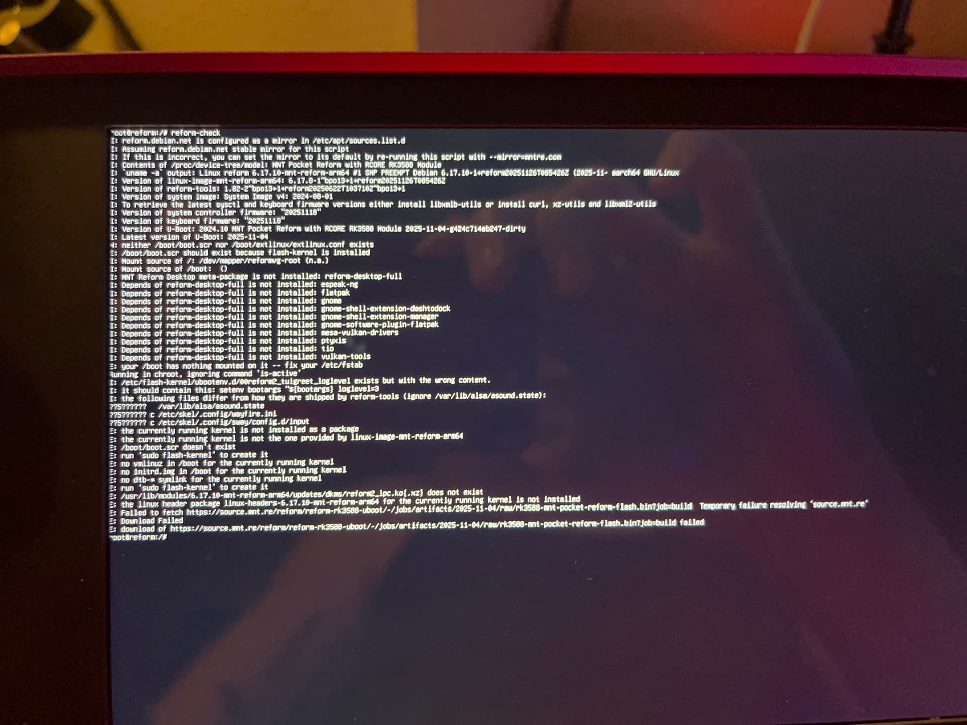

While you are in the chroot, you can try things like running reform-check (no need to use sudo because you are root).
It would also be interesting to see what you get with cat /proc/cmdline.
From inside chroot:
(I don’t know why the text is so tiny)

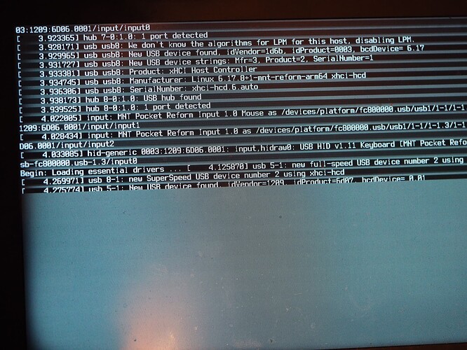

Oh wow I actually also had trouble after upgrading my firmware (no other changes to my system during that uptime). When rebooting I first was greeted with this:
Then this:
The next boot was just a blank screen, so I had to power cycle.
And only on the first try it booted properly. o0

Could you again chroot into your encrypted system and run reform-check but now with /boot mounted and internet connected and /etc/resolv.conf copied?
